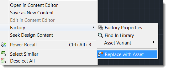

  2. Right-click to view the context menu.
  3. Select Factory, and then select Replace with Asset.
