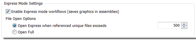

Express Mode settings are on the Assembly tab in Inventor Options.
If enabled, Express Mode automatically invokes when a file exceeds the size setting. Open Full turns off Express Mode and loads all component data each time you open a layout.
