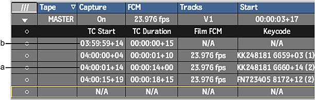

To slip the keycode for a given tape:
Sequences of timecode on the tape are associated to keycode values. If no keycode is available from the telecine log(s) you loaded, N/A (not available) appears for the sequence.
(a) Timecode start and duration defines sequence, with corresponding keycode (b) Timecode without corresponding keycode
The keycode values associated to the timecode sequence (defined by the values in TC Start and TC Duration fields) are altered.
