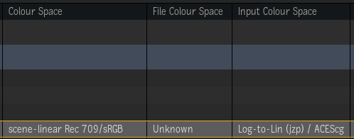

The Media List view optionally shows various colour space metadata relevant to import. (Columns may be enabled by right clicking in the table header.)
The Input Colour Space and Colour Space are also shown in the MediaHub Preview panel Clip Info.
