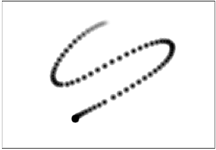

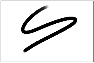

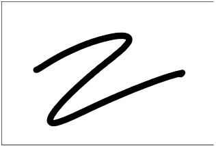

- Rate
- Determines the rate at which brush strokes are applied to the canvas. Use a high value to produce a smooth continuous stroke, or a low value to produce a less continuous stroke with larger gaps between brush images. The Fixed Rate button determines whether the consistency of the stroke is dependent on the speed at which you move the pen or mouse. For example, to create a stroke of evenly spaced dots, set the Rate field to 20 percent and enable Fixed Rate.
 Rate attribute value = 100
 Rate attribute value = 25

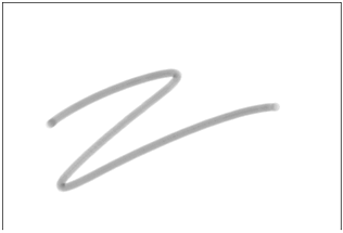

- Pressure
- Affects the transparency of the paint applied to the image. To apply opaque paint, use a high percentage value. For more transparent paint, use a low value. The Pressure attribute differs from the Opacity attribute in that you can set the Pressure attribute mode so that the paint transparency varies according to the pressure applied to the pen or the direction of the brush.
 Pressure attribute value at 100%
 Pressure attribute value at 50%

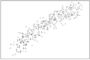

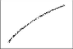

- Jitter
- Randomizes the brush strokes applied to the image. A high value produces a greater dispersion of paint, while a low value produces a greater concentration.
 Jitter attribute value at 100%
 Jitter attribute value at 10%

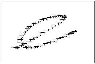

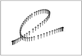

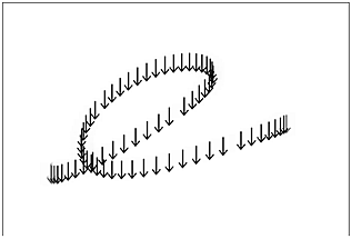

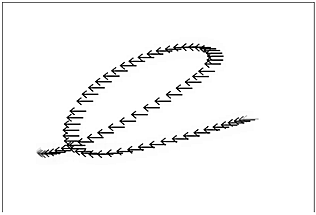

- Direction
- Causes the brush to rotate around the Z-axis and can be used to produce a calligraphy effect. The effect of the Direction attribute is most noticeable when used with one of the elliptical or star brushes. The value of the Direction attribute causes the brush strokes to rotate by 90 degrees for each increment of 25 percent.
 Direction attribute value at 100%
 Direction attribute value at 75%
 Direction attribute value at 50%
 Direction attribute value at 25%
