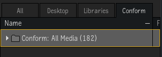

You can also manually add clips from the Media Panel to the Conform Media folder: drag-and-drop them to the Conform Media folder. This does not clear already present sources.
Tip: Clip the top-left Conform tab for the Media Panel to display only the sources.

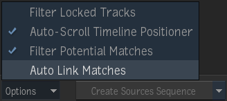

Auto Link Matches
It is also possible to automatically link events with a single match clip (green checkmark) after the Search Location is set or modified, by enabling the Auto Link Matches option. The Auto Link Matches option is available from the Options menu.
- The option is disabled by default.
- The option status is persistent and saved within the user profile.
