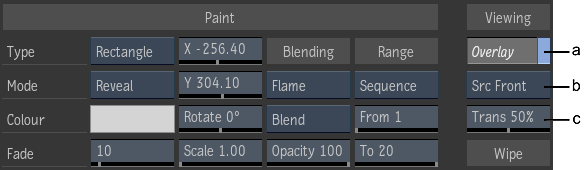

To display the reference image:
  1. Enable the Overlay button (Tab).
    (a) Overlay button  (b) Reference button  (c) Transparency field  
    The reference image appears by default at 50% transparency.
  2. Select the reference image you want to display from the Reference box.
  3. If you selected Source Matte or Source Front, select an image from the Sources list.
  4. With the reference image, you can:
    • Hold down Ctrl+Shift and drag the source front or source matte to offset it to preview a Reveal operation.
    • Scale the image, by entering a value in the Scale field.
    • Rotate the image, by entering the angle of rotation in the Rotate field.
    • Set the Slip value in the Sources list to show a reference image at a different frame relative to the actual frame position. See Slipping a Reference Image.
    • Set the transparency for the reference image in the Transparency field.
