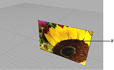

All transformations that you apply to the selected axis are applied to the objects connected to the axis. For example, if the position of a surface's axis is set to 500, 100, 0, then its surface is placed at 500 on the X-axis, 100 on the Y-axis, and 0 on the Z-axis.
(a) Surface is placed in the scene at 500, 100, 0
