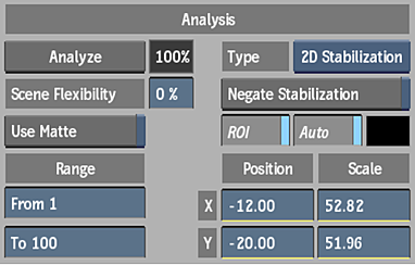

Analysis Settings
- Analyze button
- Click to run the stabilization analysis.
During analysis, the viewport defaults to the Front view, and the frame advances as the stabilization is calculated. Progress can be monitored by the keyframes that have been created during analysis and the percentage of completion displayed next to the Analyze button. Track points are displayed on the clip to indicate how the stabilization was tracked.
- Progress field
- Displays the percentage of the analysis that is complete. Non-editable.
- Scene Flexibility field
- Displays the level of focus on rigid objects that move in the clip. Enter 0% to focus on a single rigid object as it moves or 100% to analyse all visible motion paths.
If the analysis has no scene flexibility, the stabilization will focus on a single rigid object as it moves in the clip. Use the following values as a general guideline:
| Select:
To:
| 0%-20%
Stabilize a pan, tilt, zoom, or the motion of a single rigid object that is visible during the entire analysis.
| 30%-70%
Stabilize objects that change their shape or depth, and exclude objects that are smaller or moving rapidly.
| 80%-100%
Stabilize all visible movements.
- Use Matte button
- Enable to exclude black areas on the matte from analysis on the front clip, and constrain the Analysis region.
- Range From field
- Displays the value of the first frame to include in the analysis. Editable.
- Range To field
- Displays the value of the last frame to include in the analysis. Editable.
- Stabilization Method box
- Select whether to perform a two-dimensional or perspective analysis.
- Negate Stabilization button
- Enable to apply the inverted parameter values.
- Region of Interest button
- Enable to display a rectangle that can be resized to indicate the region you want to analyse on the front clip.
Select Front from the View box.
- Auto button
- Enable to automatically track motion within the region of interest.
At each frame, the position of the region of interest is updated based on the motion within the area. If this button is disabled, and the region of interest was not previously tracked, the region of interest remains static.
