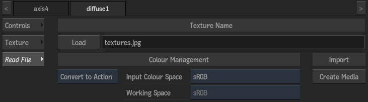

When importing through the Import node (3D models in FBX or 3DStudio formats, and Photoshop PSD files), or editing the Read File menu of a texture map, the following options are available if Colour Management is active:
| Select: | To: |
| Auto Convert | Convert content using the media file's metadata (such as OpenEXR), using a rule, or by manually selecting the Input Colour Space and the Working Space.
Auto Convert allows you to set the media to any Working Space of your liking and does not change if you later switch to Action Working. |
| Tag Only | Tag content with one of the various colour spaces available in the list, using media file metadata, or using a user-defined colour space. Tagged media is not converted to the destination colour space. Flame Assist displays it in the destination colour space for viewing purposes. The original media remains in its original format and colour space. |
| Convert to Action | Defer the choice of the working colour space to the Action Setup menu Colour Management settings. This allows you to manage the working colour space of every media imported with Convert to Action from the Action preferences. |
