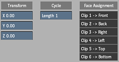

| Cubic (Spliced Faces) | A type of cubic map available as an input format using a different frames displayed as an unfolded cube showing six sides of the image. To use this input type, frames from the input clip are used as the 6 faces. |

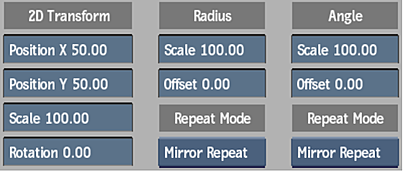

| Polar | A coordinate system for locating points in which each point on a plane is determined by a distance from a fixed point and an angle from a fixed direction. When using this input format, only Cartesian is available as the output format. |
| Cartesian | A coordinate system for locating points on a plane by measuring the horizontal and vertical distances from an arbitrary origin to a point. When using this input format, only Polar is available as the output format. |
These Transform settings apply to Cylindrical, Angular, Spheric, and Cubic, (Horizontal or Vertical) input formats.
In addition to the common transform settings, a Cubic (Spliced Faces) input format also contains the following settings:
