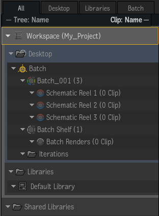

Tab Navigation
The top of the Media panel displays a number of tabs. Click a tab to focus on a specific area of interest in the Media panel.
- All
- Displays all areas of the Media panel: Desktop, Libraries, and Batch.
- Desktop
- Displays each instance of Batch, along with their schematic reels, shelves, and iterations. While Flame Assist does not have an explicit Reels view on the Desktop, it nonetheless maintains the Reels structure from material imported from Flame, in the Media panel.
- Libraries
- Displays only the Libraries and Shared Libraries folders.
- Batch
- Displays only the currently-active Batch, along with its schematic reels, Batch shelf, and iterations.
- Conform
- Only available while working in Conform, replacing the Batch tab described above. Displays only media available for the conform, filtered by match criteria.
- BFX
- Only available while working in Batch FX, replacing the Batch tab described above. Displays only media used in Batch FX.

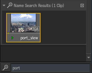

To perform a simple name search, enter text in the field at the bottom of the Media panel and press Enter. A Name Search Results area appears near the bottom of the Media panel to display the search results.

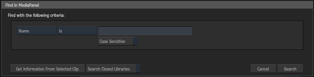

If you need a more advanced Media panel search, click the magnifying glass icon to open the Find in Media Panel window.
Here are some tips for advanced searches:
- Many options are available in the first criteria box, such as Name, Resolution, Tape, and Comment. Other criteria is displayed to further refine your search, depending on the selection in this box.
- Click Get Information From Selected Clip to fill the current search field with the information from the currently selected clip.
- Click Search Closed Libraries to also search the contents of closed Libraries.
- A Library remains closed if the Advanced Search cannot find any match.
- A Library is opened if the Advanced Search finds a match.
