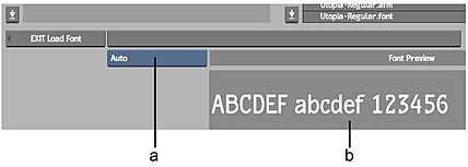

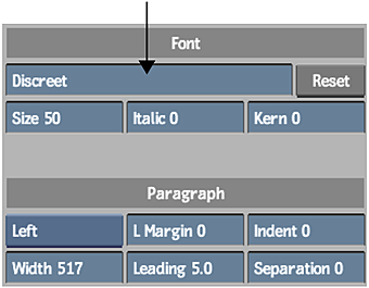

  1. In the Font section of the Text menu, click the Font field.
    The font library appears.
    (a) Font Type box  (b) Font Preview window  
  2. In the Font Type box, select the font type you want to load.
    Type Description
    Type 1 A single-byte font type designed for Roman language fonts. Soft-links to the Adobe® Postscript® Type 1 fonts installed with the system or supplied by Autodesk are contained in /opt/Autodesk/font directory.
    CID A multi-byte adaptation of Adobe Postscript Type 1 fonts, well-suited to representing the large character sets of Asian languages such as Japanese, Korean and Chinese.
    TrueType A widely used cross-platform font format.
    OpenType® A font developed by Adobe and Microsoft® that supports expanded character sets and layouts.
    Auto Displays all font types, detecting the type automatically.
  3. In the file browser, navigate to the directory that contains the font you want to load.
  4. Preview a font. Do one of the following:
    • Select a font to see it with sample text in the Font Preview window.
      The sample text can be the text you selected in the text layer, or text that you enter by clicking the Font Preview window to display the on-screen keyboard.
    • In the Proxies/Titles box, select Proxies to preview fonts. If no proxy appears, click Generate Proxies to generate a font proxy.
      This process may take a while, but once you create the proxies, the settings are retained. Each time you return to the font library, you can toggle between viewing font titles and font proxies by selecting Proxies or Titles.
  5. Select the font.
  6. Click Load.
    The Text menu reappears with the name of the new font in the Font field.
