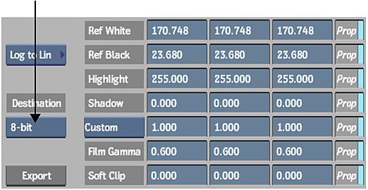

The Conversion LUT Type and the field values are all updated with preset conversion parameters. In Batch FX, a note is added with a description of the preset's usage.

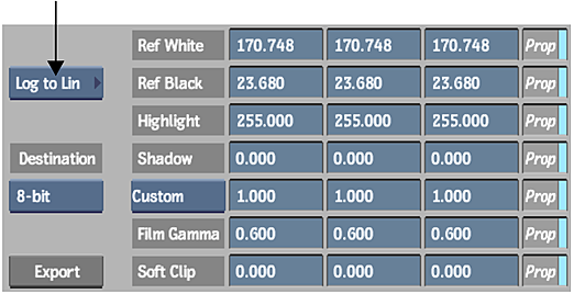

| Select: | To: |
| Colour Transform | Apply a colour transform based on the Academy/ASC colour transform XML format, as well as several other supported LUT and transform formats. |
| PhotoMap | Begin with a default curve for tone mapping. |
| 3D LUT | Import a 3D LUT. Note that this mode is superseded by Colour Transform. |
| 1D LUT | Import a 1D LUT. Note that some 1D LUTs are intended for integer values and others are intended for floating-point values. Most 1D LUTs will also load in Colour Transform mode. |
| EXR Display | Begin with a default curve for tone mapping. |
| Gamma | Begin with a default curve for applying or removing gamma or offsets. |
| Lin to Log | Begin with a default curve for converting linear or video data to logarithmic data. |
| Log to Lin | Begin with a default curve for converting logarithmic data to linear or video data. |
