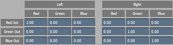

| Select: | To: |
| Custom | Customize the RGB left and right gain factor values. With this option, you can create anaglyph results based on the 3D lenses that will be used. Note: This option is available in Batch FXand the Modular Keyer.
