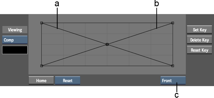

To adjust the luminance curve:
The Luminance curve appears.
(a) Front matte curve (b) Back matte curve (c) Front/Back box

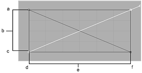

The selected curve changes to white.
(a) 255 (White) (b) Output (remapping of luminance values) (c) 0 (Black) (d) 0 (Black) (e) Input (current luminance values) (f) 255 (White)
