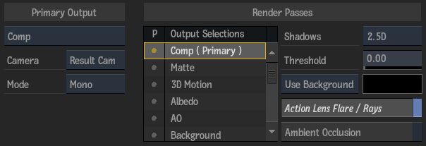

For each item in the Render Layers List, you can refine the parameters using the Outputs tab.
Primary Output Section
- Primary Output box
- Select a primary output type. Render Passes options change based on the primary output type.
Note: If you accessed Action from the timeline, a single Render Layer is available with Comp and Matte enabled.
- Camera box
- Select which camera or stereo rig to assign to the render layer.
- Mode box
- Select a render mode. Selecting the Stereo mode and a stereo camera results in left and right clips when processed. Selecting Stereo mode and any monoscopic camera results in two identical clips. Selecting Left, Right, or Mono results in a single output, regardless of the camera selected.
Render Passes Section
In the Output Selections List, the primary output is indicated, such as Matte (Primary). You can add as many other render passes to an output as you want. Simply click the dot to the left of the pass name (a coloured dot indicates that a render pass is enabled for the selected render layer).
Tip: To see the result of a render pass without enabling it for the selected render layer, click the name of the render pass in the Output Selections List.
