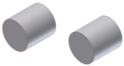

Dim oCylinder2 As ComponentOccurrence
Set oCylinder2 = oAssyDoc.ComponentDefinition.Occurrences.AddByComponentDefinition _
   (oCylinder1.Definition, oPositionMatrix)
In Autodesk Inventor, the preceding code results in two cylinders in the assembly, looking something like the following figure.

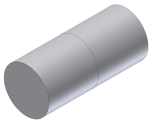

Set oConstr = oAxisDef.Constraints.AddMateConstraint _
   (oCylFace1, oCylFace2, 0, kNoInference, kNoInference)
This results in the following figure with the intended relationship between the two cylinders.
