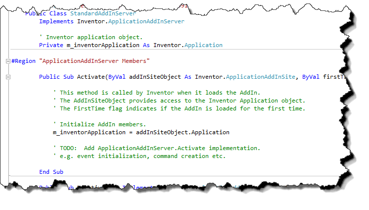

The project that's created using the template is a skeleton add-in. When Inventor starts your add-in it begins by calling the Activate method, which is shown in the picture below. A critical thing happens in this call, an object is passed to your add-in through the addInSite argument of the Activate method. This object supports an Application property which your add-in can use to gain access to Inventor's Application object and the entire API. You'll notice that the template is assigning the reference returned by the Application property to a local member variable so the add-in can maintain a reference to the Application object. It's also typically in the Activate method where your add-in will add its user interface to the Inventor's user interface using Inventor's API. It will also connect to any events that it needs to monitor. Once it's been loaded and is running the add-in doesn't do anything except react to events as they occur. For example, it would respond to the click when the user clicks one of its custom commands.

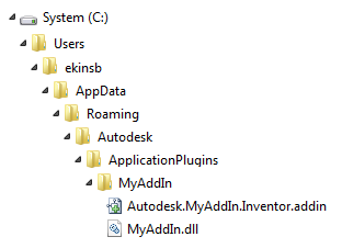

In order to allow your add-in to be found by Inventor, you need to place a special file in one of a few different directories. This file describes your add-in and also indicates where your add-in dll is on the computer. When Inventor is started, it scans these directories and reads these files to determine which add-ins should be loaded.
The file that Inventor looks for has a .addin extension. A .addin file was automatically created for you when you created your add-in project, as is illustrated below.
The conents of the .addin file are shown below. As you can see it uses xml to format the data.

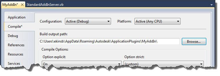

Now that you have your add-in dll and have created your .addin file you need to know where to place those files so that Inventor can find and load your add-in.
The following four locations are supported. You can choose any one of the four depending on the needs of your add-in. Your .addin file can exist in any one of the following four locations or any subdirectory. The "%XXXX%" portion of each of the paths is an operating system defined variable. When using Explorer you can enter it as part of the path and Explorer will evaluate it to use the actual path defined by the variable.
There are a couple of things to consider when determining where to put your add-in. If you choose a location that is available to all users it will require administrator privileges to install your add-in. In most cases, computers are rarely shared amongst multiple users so a per-user installation is usually sufficient.
If you plan on actively updating your add-in for each release of Inventor then making it version dependent can be good so that the user will only have access to an add-in that was written for and tested with the version of Inventor they're using. Because significant effort is made to allow the API to be upward compatible you should be able to run older add-ins with newer versions of Inventor. Because of this you can supply and add-in and not tie it to a specific version assuming that it will continue to run as newer versions of Inventor are released.
Also, because you can specify versions that your add-in is compatible within the .addin file you can still use a version independent .addin location and control the versioning through the .addin file. Apps that are provided through the Autodesk Exchange Store take advantage of this and are installed in the "Per User, Version Independent" location.

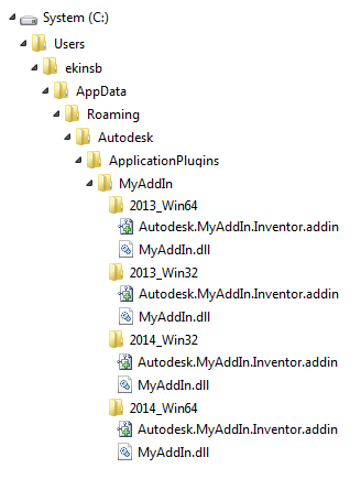

A new feature added in Inventor 2013 is the ability to create and add-in that can be deployed by simply copying a directory into a certain location on the user's computer. The change made to enable this is that Inventor looks in the four directories above for .addin file and now also looks in any subdirectories within those four directories. If you create a directory that contains your .addin file and your addin dll and set the Assembly element of your .addin file to have just the name of your dll without any path, you can copy that folder to any of the folders above and Inventor will find and load your addin. Below is an example of the directories and files for an add-in named "MyAddin". This shows the full path for the "%APPDATA%\Autodesk\ApplicationPlugins" location.
It's also possible to create much more complex configurations for a drag and drop type of add-in. For example you can have an add-in where you have one dll for 32-bit and another one for 64-bit. You might also have a dll that is specific to a certain version of Inventor and a different dll for another Inventor version. The possible directory structure to support this is shown below. In order for it to support multiple versions of Inventor you must put the folder in one of the two version independent folders. An example of how the folders might look for an add-in like this is demonstrated in the picture below. What's happening here is that you are essentially delivering four different add-ins, each with their own .addin file and dll. Which version and which OS the add-ins load is controlled by the contents of the .addin file for each of the add-ins.

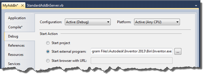

Once you've compiled your add-in and have a dll you'll need to follow the steps below in order to enable debugging. With registry-free add-ins there isn't any difference between debugging with 32 or 64-bit Inventor.
