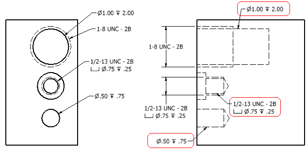

In the example below there are three holes created using various modeling techniques. The top one was created using an extrude feature and a subsequent thread feature was added to it. The middle feature is a counter bore hole feature that is also tapped. The bottom feature is a standard hole.
To get any of the four notes shown on the left-hand view the only required input is the Position to define the text position and a DrawingCurve defining which curve the note should point to. The text position is enough to determine where the note points to the circle. Notice that in the case of the thread feature you get a thread note if the input drawing curve is for the thread and you get a hole note if the drawing curve is for the hole. The right view demonstrates some other possibilities. The three circled notes can be created by defining the text position point, the geometry to point to and a point along that geometry. The geometry and point on the geometry are defined by providing a GeometryIntent object as input to the HoleOrThreadEdge argument. The other two notes in the right view require the input of the text position and one of the lines that represents the diameter of the thread. In addition, the LinearDiameterType argument must be set to True.
