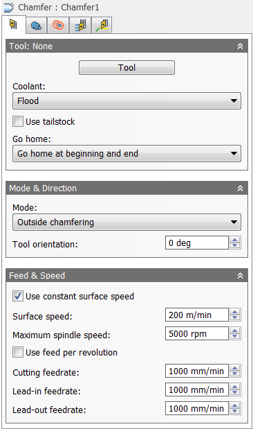

Tool tab settings
Tool
Select a tool from the library, or create a new tool.
Coolant
Select the type of coolant that should be used with the tool. Output options will vary depending on the machine capabilities and machine postprocessor configuration.
Use Tailstock
A tailstock can be used to support the open end of the workpiece. This is particularly useful when the workpiece is relatively long and slender, or large and heavy. Failing to use a tailstock can cause the workpiece to flex while being cut, causing poor surface finish (chatter) and inaccuracies.
For this option to take effect, your machine needs a programmable tailstock and your post processor has to be configured to write the code your specific machine needs. Once configured, the post will output the appropriate code to extend the tailstock forward at the beginning of the operation and retract the tailstock backward at the end of the operation.
Go Home
The Home position is a retract point in Z, relative to the defined Work Coordinate System (WCS). WCS is defined in the Setup dialog, on the Setup tab.
You can force the tool to move to the Home position prior to starting the operation, or once the operation has finished. The tool will always pull out of the stock in the X axis until it reaches the Clearance height, then move to the Home position in the Z. If you use the same tool for several operations in a row, you can use these options to reduce wasted motion and keep the tool from returning to the Home position.
Don't go home
The tool will start at the Clearance Height above the first cut position. When finished, the tool will remain above the last move, at the Clearance Height.
Go home at beginning
The tool will start at the intersection of the Clearance Height and the Home Position. When finished, the tool will remain above the last move, at the Clearance Height.
Go home at end
The tool will start at the Clearance Height above the first cut position. When finished, the tool will return to the intersection of the Clearance Height and the Home Position.
Go home at beginning and end
The tool will start and end at the intersection of the Clearance Height and the Home Position.
Turning Mode
Determines whether the tool machines on the Outside Diameter or Inside Diameter, as well as the controlling the approach/retract direction.
Outside Chamfer (top) - Inside Chamfer (bottom)
Tool Orientation
You can change the direction the tool points. This is most useful if your lathe turret has a programmable B axis. Your post processor will need to support posting from this value. However you can simply set your tool in the turret/holder at a fixed angle.
Tool Orientation @ 45 degrees.
Tool Orientation @ 90 degrees.
Use constant surface speed
Enable to automatically adjust the spindle speed to maintain a constant surface speed between the tool and the workpiece as the cutting diameter changes . Constant Surface Speed (CSS) is specified using G96 on most machines.
Note: For more information, see the Inventor HSM Help topic:About Turning Feeds & Speeds.
Surface Speed
The cutting speed expressed as the speed of the tool across the part surface. Expressed as Ft/min or M/min depending on the current Units setting.
Spindle Speed
The rotational speed of the spindle.
Maximum Spindle Speed
Specifies the maximum allowed spindle speed when using Constant Surface Speed (CSS).
Use Feed per Revolution
Enable to switch from Distance over Time (In/Min or MM/min), to Feed Per Revolution (IPR or MMPR). This type of feedrate creates a constant chip load regardless of the spindle RPM.
Cutting Feedrate
Feed used in cutting moves. Input based on the Use Feed per Revolution setting and the current Units.
Lead-In Feedrate
Feed used when leading in to a cutting move. Input based on the Use Feed per Revolution setting and the current Units.
Lead-Out Feedrate
Feed used when leading out from a cutting move. Input based on the Use Feed per Revolution setting and the current Units.

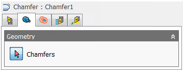

Geometry tab settings
Chamfers
Use the Chamfers selection button to select one or more circular edges for chamfer creation.
Edge selection shown in blue

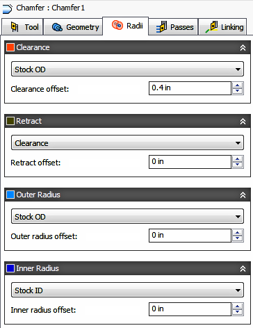

Radii tab settings
Radii Options for Outside Turning .
Radii Options for Inside Turning.
The Radii tab allows you to set a radial containment area for machining. The dialog will change depending on if the Turning Mode (Tool tab parameter) is set to Outside chamfering or Inside chamfering. These parameters are color coded for easy identification.
    Order for Outside Turning.
  • Clearance = Fully retracted safe zone
  • Retract = Above the surface to machine
  • Outer = Actual surface to be machined
  • Inner = Maximum cutting depth
    Order for Inside Turning.
  • Inner = Actual surface to be machined
  • Outer = Maximum cutting depth

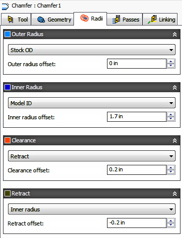

Clearance
Shown in Orange, this controls the radius where the tool rapids to at the start and end of the toolpath. For OD machining this position is outside the part. For ID machining this position is from an inside tube or bore. The tool approaches from and retracts to this position.
Shown in Orange, "From" sets the Clearance radius reference position. The reference can be in relation to the Stock, the Model, a specified Radius, Diameter, or any of the other Radial positions. This reference position can be shifted with a positive or negative offset value.
Note: The Clearance radius must be larger than, or equal to, the Retract, the Outer radius and Inner radius to generate a valid toolpath.
Offset
Use this offset to shift the position relative to the Reference point selected above. You can make positive or negative adjustments as needed.
    For Outside Turning.
  • In This Example...
  • Outer = Stock OD (Model + 1mm stock)
  • Retract = Outer + 5mm Offset
  • Clearance = Retract + 5mm Offset
    For Inside Turning.
  • Inner = Selected ID Face (Selection)
  • Retract = Inner -.120 In. Offset
  • Clearance = Retract -.260 In. Offset
Retract
Shown in Dark Green, this controls the position above the surface you plan to machine. This is the radius where the tool retracts to between cuts.
Shown in Dark Green, "From" sets the Retract reference position. The reference can be in relation to the Stock, the Model, a specified Radius, Diameter, or any of the other Radial positions. This reference position can be shifted with a positive or negative offset value.
Offset
Same function as the Clearance Offset shown above.
Outer Radius
Shown in Light Blue, this defines the largest radial boundary of the cutting area. For Outside (OD) machining, Outer Radius defines the outer stock surface you plan to machine. For Inside (ID) machining, Outer Radius controls the maximum depth for the cut area.
For Inside Turning.
Shown in Light Blue, "From" sets the Outer Radius reference position. The reference can be in relation to the Stock, the Model, a specified Radius, Diameter, or any of the other Radial positions. This reference position can be shifted with a positive or negative offset value.
Offset
Inner Radius
Shown in Dark Blue, this defines the smallest radial boundary of the cutting area. For Outside (OD) machining, Inner Radius controls the maximum depth for the cut area . For Inside (ID) machining, Inner Radius defines the inner stock surface you plan to machine.
For Inside Turning.
Shown in Dark Blue, "From" sets the Inner Radius reference position. The reference can be in relation to the Stock, the Model, a specified Radius, Diameter, or any of the other Radial positions. This reference position can be shifted with a positive or negative offset value.
Same as the Outer Radius "From" options shown above.
Offset

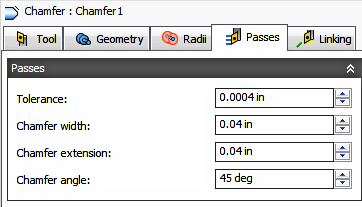

Passes tab settings
Tolerance
Also known as the Cut Tolerance, this Tolerance is for toolpath generation and geometry triangulation. Any additional filtering tolerances, like Smoothing, must be added to this tolerance to get the Total Tolerance for the cut..
Loose Tolerance .100
Tight Tolerance .001
CNC machine motion is controlled using G1 line and G2 G3 arc commands. To accommodate this, Inventor HSM approximates spline and surface toolpaths by linearizing them; creating many short line segments to approximate the desired shape. How accurately the toolpath matches the desired shape depends largely on the number of lines used. More lines result in a toolpath that more closely approximates the nominal shape of the spline or surface.
Data Starving
A tighter tolerance will result in a more accurate path with smaller line segments. It is tempting to always use very tight tolerances, but there are trade-offs including longer toolpath calculation times, large G-code files and very short line moves. Each can be a problem depending on your situation. Inventor HSM will calculate quickly on almost any computer. But if you have an older NC control with limited memory and a machine with slower axis drives, the toolpath motion might appear jumpy. This is a phenomenon known as data starvation. This Tolerance, along with Smoothing, can reduce your program size and improve your machines performance.
Data starving occurs when the control becomes so overwhelmed with data that it cannot keep up. CNC controls can only process a finite number of lines of code (blocks) per second. That can be as few as 40 blocks/second on older machines and 1,000 blocks/second or more on a newer machines. Short line moves and high feedrates can force the processing rate beyond what the control can handle. When that happens, the machine must pause after each move and wait for the next servo command from the control.
Chamfer Width
The (additional) width of the chamfer. For edges that are not already chamfered, this is the final width of the chamfer. (illustration shown below)
If you selected an edge that already has a chamfer, this is the additional amount to chamfer the edge.
Chamfer Extension
Distance to extend the chamfer cutting pass, past the chamfer edge. (illustration shown below)
Chamfer Angle
The angle of the chamfer measured from the Z-axis. (illustration shown below)
Shown left to right: Extension - Chamfer Width - Angle

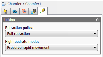

Linking tab settings
Retraction Policy
Controls how the tool should retract to the clearance diameter after every cutting pass. or just retract a short distance away from the job. The distance is determined by the Safe Distance value.
Full retraction - completely retracts the tool to the Retract Height at the end of the pass before moving above the start of the next pass. Minimum retraction - moves straight up to the lowest height where the tool clears the workpiece, plus any specified safe distance.
High Feedrate Mode
Specifies when rapid movements should be output as true rapids (G0) and when they should be output as high feedrate movements (G1).
This parameter is usually set to avoid collisions at rapids on machines which perform "dog-leg" movements at rapid.
High Feedrate
The feedrate to use for rapids movements output as G1 instead of G0.
