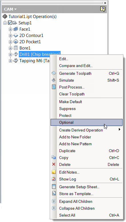

To make an operation optional, right-click the operation in the CAM Browser and select Optional from the pop-up context menu. You can make the operation non-optional again by selecting Optional once more.
Making an operation optional
