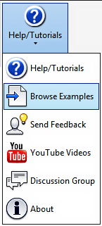

Good News: We already created a set of sample toolpaths for you to test the post. Open the Inventor HSM Help/Tutorials and go to Browse Examples . There, you'll find test files for Milling and Turning. Select the appropriate sample file, based on the type of machining and the Units you'll be working with. Select the Post Processor you think best matches your machine/control combination and create the CNC code. If you experience errors at your machine, you may want to post 1 operation at a time to simplify the debugging process.
