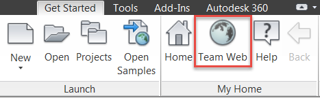

After you set the Application Option, you can start Team Web in two locations:
- From the Get Started tab My Home panel
- From the Help menu drop-down
