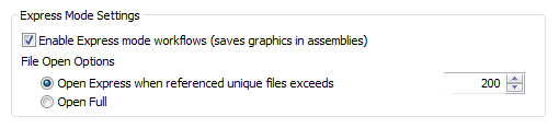

Enable Express mode
To enable Express mode and set the default open behavior in Application Options.
  1. On the ribbon, click Tools tab Options panel Application Options
  2. Click the Assembly tab.
  3. Click Enable Express mode worflows.
  4. Specify the File Open Option you wish to use. For working with large assemblies select Open Express when referenced unique files exceeds and specify the value. This value sets the default open behavior based on the unique file threshold value. This allows you to open very large assemblies in Express mode, while smaller or less complex assemblies fully open. File open times are based on factors such as number of occurrences, complexity of model geometry, and system hardware specifications.
Tip: To revert the assembly file back to the original size, close all documents and then clear the Enable Express mode workflows check box. The next time you open and save the assembly file, the express data is removed.

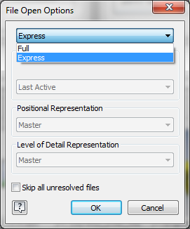

Enter Express mode
After you enable Express mode and save an assembly, the threshold value is used to invoke Load Express when opening an assembly that exceeds the unique files value. When opening an assembly you can override the default File Open behavior using one of the following techniques:
  • Select Full or Express in the drop down list.
  • Use File Open Options
    You can also use the File Open Options to specify opening the assembly in Full or Express mode. Access to File Open Options is available in the Home window
    or the Open dialog box.
    Note: If the drop down list is not enabled, the assembly has not been saved with the necessary display data and will fully open.
