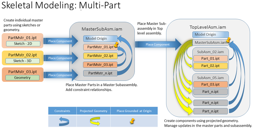

The Multi-Level Process uses individual master parts comprised of sketches to represent the final assembly. The master parts are placed and constrained in a Master sub-assembly. The Master sub-assembly is placed in the Top-level assembly. Inside the Top-level assembly, the individual 3D components are modeled using projected geometry from the Master sub-assembly and its master parts. The 3D components can be contained in logical sub-assemblies or separate, according to the design requirements.

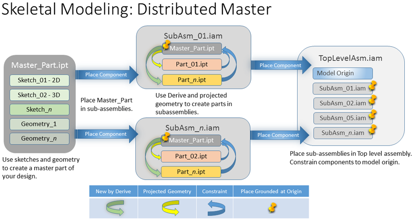

The Distributed Master uses a single master part, comprised of sketches and geometry, to define the final assembly. The Master Part is referenced in the various sub-assemblies and parts as needed. The Master Part controls the overall layout. The assembly and sub-assemblies are defined or placed with respect to the Master Part. Each sub-assembly has its own skeleton and drive a portion of the design within itself. Higher level skeletons are used to drive the overall layout or mechanism of the assembly while lower level skeletons can be used to drive the geometry of the parts.

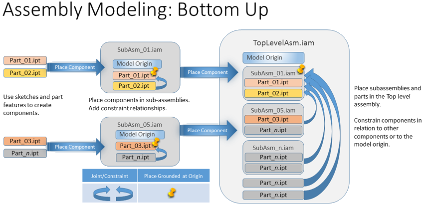

Bottom Up is the traditional way of building assemblies. First, you define the different parts. Then, you put them into sub-assemblies using assembly constraints. The sub-assemblies are then placed into higher lever assemblies up to the top level assembly and in this way, you are working your way from the bottom up. This assembly method results in assemblies with a number of relationships between parts and assemblies.
This diagram is provided as a comparison to the skeletal modeling methods mentioned above.

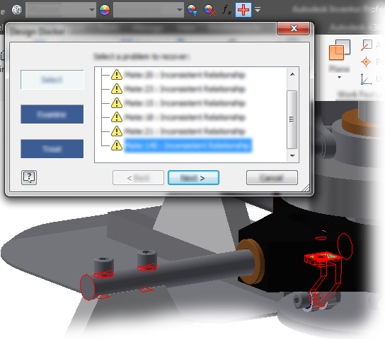

When resolve errors occur a red cross displays in the Quick Access Toolbar (QAT). Clicking that button launches the Design Doctor which reports the errors. In the dialog box, select an error to highlight where the error occurs.
When model features produce errors, these need to be resolved before releasing your designs. Inventor provides Design Doctor (assemblies) and Sketch Doctor (parts) tools to help identify and resolve errors. In particular, missing references and constraint failures are key warnings, and affect Inventor performance. While you can work with missing parts and failed constraints, it is not good practice to do so for extended periods of time. Inventor finds that something is sick, performs an audit, and updates it every time you switch back to that file. If all errors are removed, assemblies behave more predictably and performance improves.
