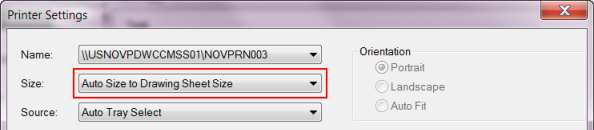

- Do any of the following:
		  Click the Size drop-down arrow and select
			 Auto Size to Drawing Sheet Size to batch print multiple drawing (.idw) files set to different sheet sizes and orientation. This new option automatically chooses the appropriate paper size and orientation as specified in the drawing sheet setting.
		   This setting is only available when the files in the Task Scheduler Print Files dialog box are drawing (.idw) files.
