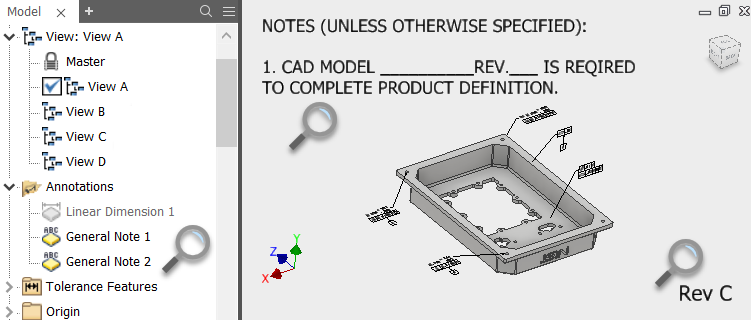

Tip: Within Inventor, the notes that you add to the 3D model do not rotate and are always normal to the active view. The note text in the exported PDF file rotates with the view. For best results refer to the following image as an example and do the following before you export:
- Activate views B, C, and D and turn off the visibility of General Note 1 and 2.
- Make View A active, verify the model orientation and note visibility is correct in the view, and then export the model.
