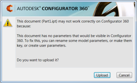

  3. Configurator 360 reads parameters and displays an editable dialog box.
    • Check the key check boxes that include all important parameters you wish to include in your Configurator 360 user interface.
    • Rename the model parameters (change the name from the d0-style) to be included in your Configurator 360 user interface. All renamed model parameters and user parameters will be included in the Configurator 360 user interface.

    • If your part file is not prepared correctly, the following error message displays:
