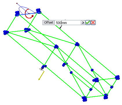

- All constraints and loads use Heads Up Display and grips to define the inputs easily. More complex settings are available in the dialog boxes. (To display the particular dialog box, right-click the graphics window after you execute the command from the ribbon, and select More Options.) To avoid unnecessary usage of complex constraints and loads, typical simplified cases use appropriate simplified commands.
- Specify constraints. Select beam or node to specify their origin. Use glyphs or dialog boxes to specify the origin and values such as Magnitude or Angle in Plane.
- A similar interactive approach is used to define the loads. The HUD always corresponds to the currently selected grip. Enter an exact value of the given parameter directly. Define Offset using absolute or relative values.
