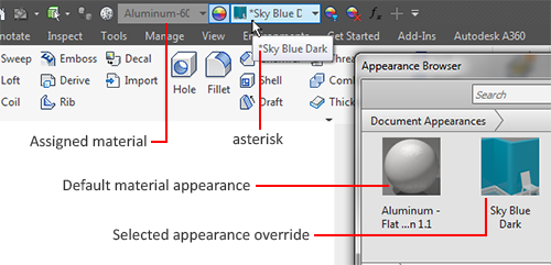

Assign an appearance to the selected object or objects, using the Quick Access Toolbar or the Appearance Browser.
Note: Materials have default appearance assignments. When you override the appearance an asterisk is added before the name in the QAT. This is done so you are aware that the assigned appearance is not the default appearance.
Document Appearance from the QAT
  - Select the component.
- In the QAT, use the Appearance list to select an appearance.
		Note: You can use CTRL+Select to add to the selection before you assign an appearance override.
Library Appearance from the QAT
  - In the QAT, click the Appearance list and at the bottom select the library where the appearance is located. The list updates to show the contents of the selected library.
- In the graphics area, select the component.
		Note: With Inventor, use CTRL+Select to build a selection set, then proceed with the next step.
- In the QAT Appearance list, select the appearance to assign to the component.

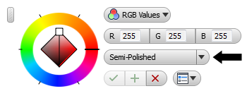

Document Appearance from a Feature or Face
   You can also use the Adjust command to copy and paste appearances from one feature or face to another.
  - Edit the part.
- In the QAT, click
		Adjust
- Using the in-canvas interface, select an Appearance.
