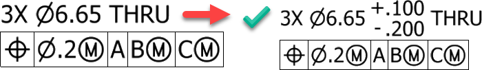

A size dimension does not have a valid tolerance associated with it.
To resolve this error, apply a tolerance to the sketch or feature dimension.
This error can also be caused by a missing material condition for a geometric position tolerance. In this case, specify a maximum or least material condition to resolve the error.
