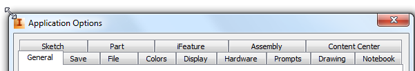

Application Options dialog box is now resizable
Select any corner of the Application Options dialog box to resize.

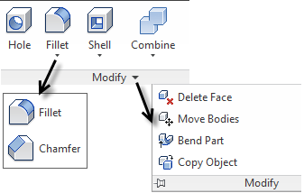

  • 3D Model and Sketch panels streamlined
    Several commands were moved from a main panel to the subpanel, or to a drop-list on the panel. For example, in a part file (.ipt) the Modify panel on the 3D Model tab is now streamlined to display fewer commands by default. The other Modify commands are moved to a drop-down menu or to the Modify expanded panel:

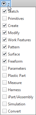

  • More panels hidden by default
    Panels with less frequently used commands or commands with duplicate access points are hidden to optimize space in the workspace. You have more room to view and work with models. For example, on the 3D Model tab, the panels Primitives, Parameters, Measure, Plastic Part, Harness, iPart/iAssembly, Simulation, and Convert are now hidden by default.
  • Access hidden panels using the new Show Panel icon
    You can access hidden panels easily, and make hidden panels visible. Click Show Panel , and then click the panel to expose on the active tab.

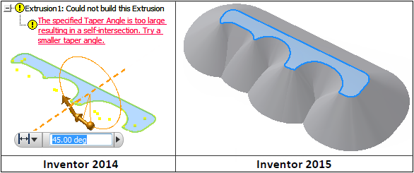

Modeling Robustness
The robustness of Shelling and Tapered Extrusions is improved. They now handle more complicated geometries. For example, in Inventor 2014, you can extrude the following profile with proper tangent constraints with a taper angle of up to only 27 degrees. In Inventor 2015, the taper angle can be anywhere from 0 through 90 degrees.
