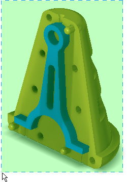

Analyze Interference
The following new functionality is added to the Analyze Interference workflow:
- You can use a crossing window to add components to the selection set. Previously you selected components one at a time.

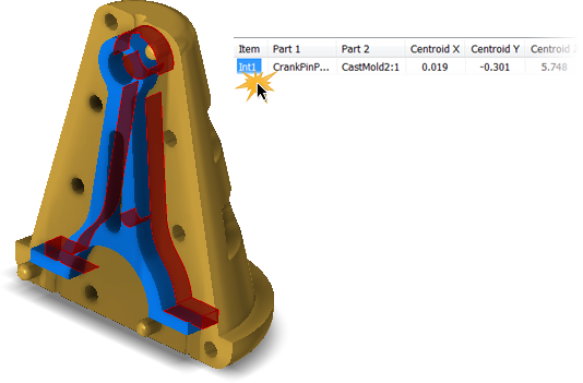

- You can now zoom to an interference. If interferences are detected, expand the dialog box and double-click an entry to zoom to the interference.

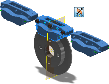

Assembly Pattern
The Midplane option is added to the assembly Pattern command. Select the Midplane option to create a pattern distributed on both sides of the original component.

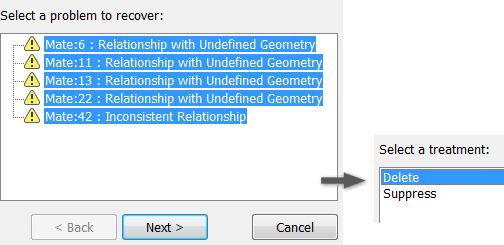

Act on Multiple Sick Constraints
You now can select multiple sick constraints within the Design Doctor and delete or suppress them.
