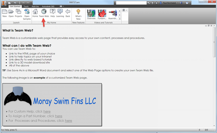

Team Web
Team Web is a customizable web page that provides easy access to your own content, processes and procedures.
You can configure Team Web to:
  • Link to the HTML page of your choice
  • Link to help topics on your intranet
  • Link to web based tutorials
  • Link to a 3D model download site
  • All of the above
You can start Team Web from multiple locations, including the Get Started tab, My Home panel. An application option in the Files tab lets you to make Team Web the default for the Inventor Home screen.

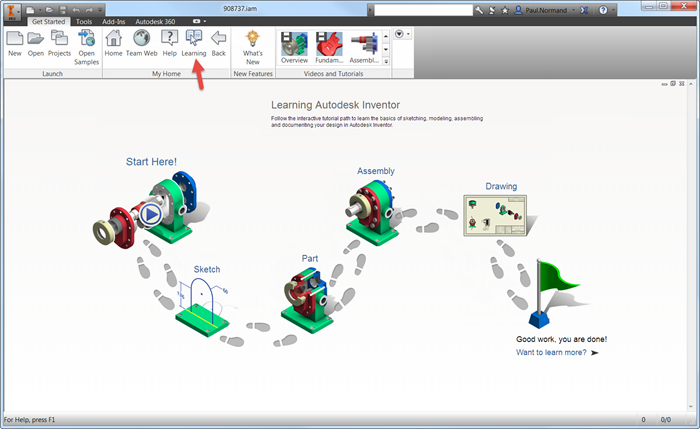

Tutorial learning path
Click the Learning entry on the Get Started tab, My Home panel to access the tutorial learning path. The tutorials provide a guided path to learning the basics of sketches and parts, assemblies, and drawings in a complete end to end workflow. Progress tracking shows what you complete. The enhanced interactive tutorial UI provides a better visual experience.
