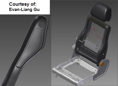

Model with Freeform
The 14 new Freeform tools provide an alternate modeling approach to explore and create freeform shaped models using direct manipulation. Start with a freeform shape (Box, Sphere, Cylinder, Torus, or Quad ball) that best represents the desired geometry. Then use the freeform edit tools to change and adjust the shape.
Use freeform along with parametric modeling to create a more visually compelling design.
You can download the freeform interactive tutorial at http://www.autodesk.com/inventor-newtutorials-2015.

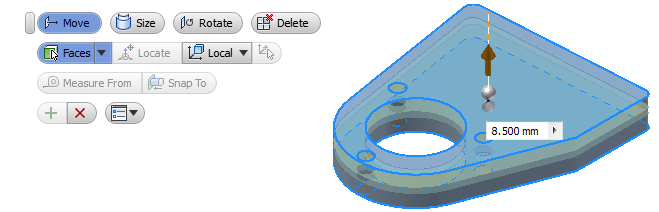

Direct Edit
Edit parts quickly with Direct Edit. You can adjust size, shape, and/or location of model features by directly manipulating the geometry. Use Direct Edit when you want to:
You can download the direct edit interactive tutorial at http://www.autodesk.com/inventor-newtutorials-2015.

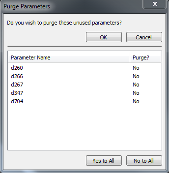

Purge all unused parameters in one action
At the bottom of the Parameters dialog box, the option Purge Unused lists all unused parameters in a separate window. There you can purge them in one action. Click Yes to All to delete all unused parameters in the document or No to All to retain the unused parameters in the current document.
To retain a parameter listed in the window, leave the default setting of No. To purge a parameter listed in the window, you can click the default setting of No to Yes before you execute the purge. Unused, exported parameters default to No in case they are used in other documents.
You can still delete parameters individually in the Parameters dialog box.

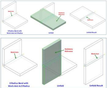

Unfold/Refold imported Sheet Metal part with zero radius bend
You can unfold and refold imported third-party sheet metal models with a zero radius bend. In the sheet metal environment, Unfold/Refold command, under Unfold Geometry, you can now select a zero radius bend. You can flatten the zero radius bend when you create a flat pattern.
For Unfold, a new face is added where the 0 radius bend edge exists. The K-factor that you define determines the area of the face.
After Refold, references that are created in unfolding the model remain. This behavior is the same as in nonzero radius bend cases.
