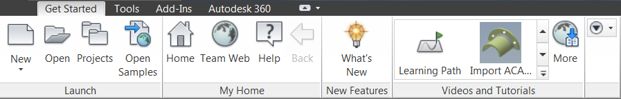

Videos and Tutorials panel
The following changes are made to the Videos and Tutorials panel:
  • The panel is enabled by default.
  • The Learning Path link for the get started tutorials is moved to the panel.
  • The 12 Learning Path guided tutorials no longer display individually in the Videos and Tutorials panel. You can access these tutorials from the Learning Path.
  • An Import AutoCAD geometry guided tutorial is included in addition to the Learning Path tutorials.
  • A More tutorials icon is provided with a direct link to the guided tutorial download site.
    Tip: Click this button to view the new tutorials we release frequently throughout the release cycle.
