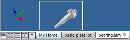

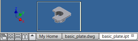

Display tabs for open documents
You can control the visibility of the tabs at the bottom of the window that bear the names of documents that are open. On the ribbon View tab, Windows panel, in the User Interface drop-down list, select, or clear the check box for Document Tabs.
