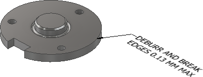

Add or edit a leader line with text
Leader Text is created with a single-segment leader by default. To create more leader segments, start the command, right-click, and click Single-Segment Leader to unselect the option.
  1. On the ribbon, click Annotate tab Text panel Leader Text .
  2. Select the anchor point on the geometry.
  3. Optionally, right-click and do any of the following:
    • Click Align to Geometry in the context menu and then select an edge or axis to orient the text.
    • Click Select Next Candidate Plane in the context menu or use the SPACEBAR shortcut to cycle through alternate planes.
  4. Click to place the leader endpoint.
  5. Add the desired text in the Format Text dialog box and then click OK or Apply to create.
  6. To edit leader text do one of the following:
    • Select the leader in the display or browser, right-click, and select Edit in the context menu.
    • Double-click the leader in the display or browser.
    Change the required values and then click OK.
