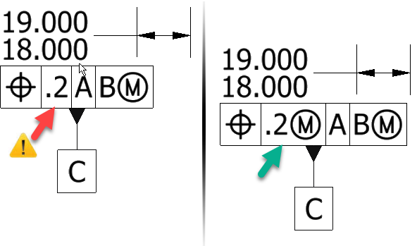

This message means that one of the following conditions exists in the model:
- A required tolerance value is zero or missing for a tolerance annotation.
- The Tolerance Zone Material Condition Modifier for a geometric tolerance has not been specified but is required. For example, for a position tolerance.
To resolve the issue, add the missing tolerance or modifier.
