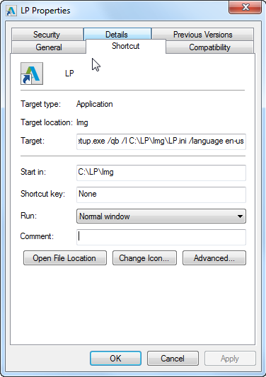

The standard method for deploying multiple languages of Inventor is:
  1. Create the deployment for Inventor using the Inventor installation media.
  2. Create one or more Inventor Language Pack deployments using the Language Pack installer.
The target line from the language pack deployment shortcut can easily be appended to a deployment script in most network management tools such as Microsoft’s SCCM. This can enable unattended and efficient multi-language Inventor deployments in even the largest enterprise networks
