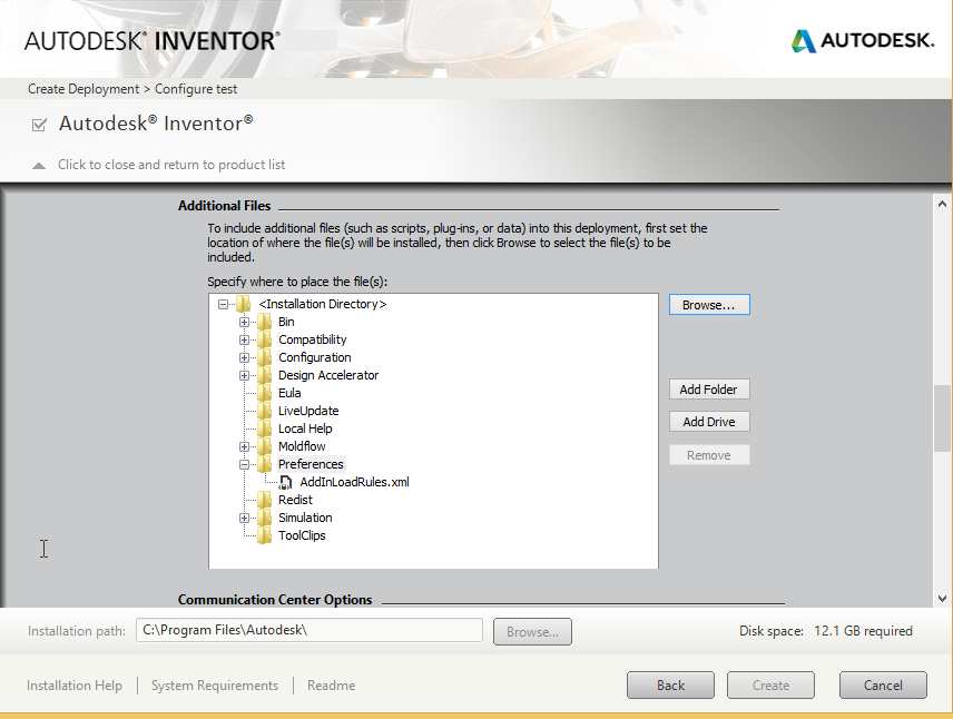

  2. Deploy the file to your users: There are 2 ways you can deploy the file:
    Option 1
    • Copy the file from the User Override location to the Administrator overrides location on each target workstation.
    Option 2
    • Add the file to a deployment using Additional Files.
