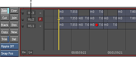

In the following example, Layer 2 is soloed. In this case, only Layer 2 is displayed in the Player and Storyboard, played out to tape, and rendered. It should be noted that although there is a shot assigned with shot priority in Layer 1, only Layer 2 shots are displayed because Solo mode takes priority.
Danger: If a layer is soloed, the Edit tools (Trash, Delete, Trim In/Trim Out, and Mark In/Out) default to 'Ripple End' behaviour, regardless of the Ripple Mode setting. If no layer is soloed, however, the Edit tools behave according to the individual Ripple Mode selected (Ripple Off, Ripple Start, or Ripple End) and apply to the active or visible layer that contains the focus point. For more information about Ripple Modes, see Trimming With Ripple Mode.
(a) Soloed layer  
