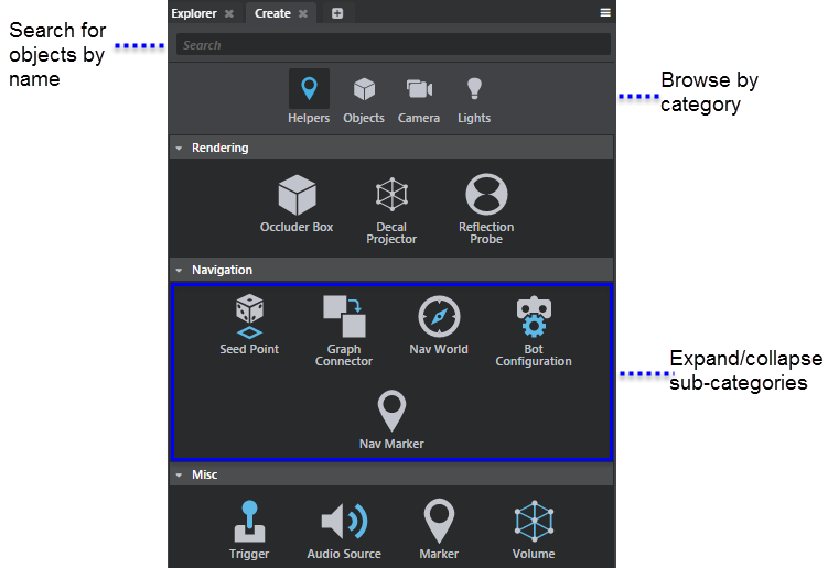

Lets you create standard level objects that can be placed and modified in the level. See also Create level objects.
Search for the object name, or browse by category of object.
The Helpers tab in the Create panel lets you create components from the following categories:
