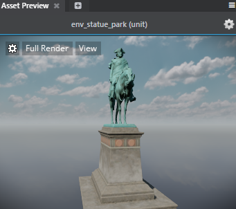

Displays assets as you browse and select them in the Asset Browser. You can zoom, pan, and tumble in the Asset Preview just like you do in the Level Viewport.

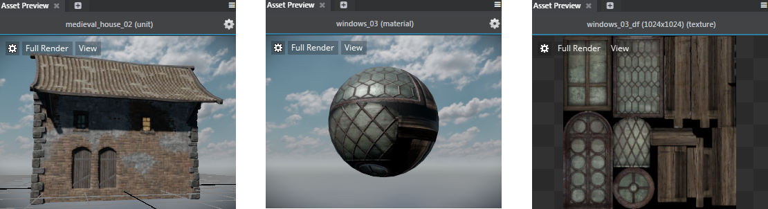

When you select a material, the Asset Preview displays the shaderball with your material applied, letting you preview the material within the current lighting environment. You can also preview 2D texture files.

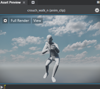

When you select an animation clip, the animation automatically plays back in the Asset Preview. To disable automatic playback, select File > Settings > Editor Settings, then enable Disable animation preview autoplay in the Property Editor.
