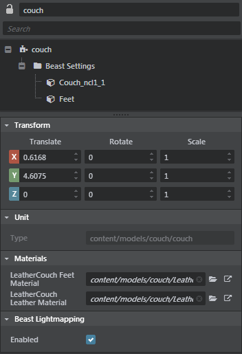

This panel is the main location where you can edit the properties of objects selected in the Asset Browser or Explorer.
You can select multiple objects in the Explorer panel to view and edit multiple shared attributes at the same time in the Property Editor.

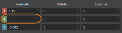

If the selected objects already share the same value for a property, the value displays in the Property Editor as usual. If their values differ, a dash displays.
