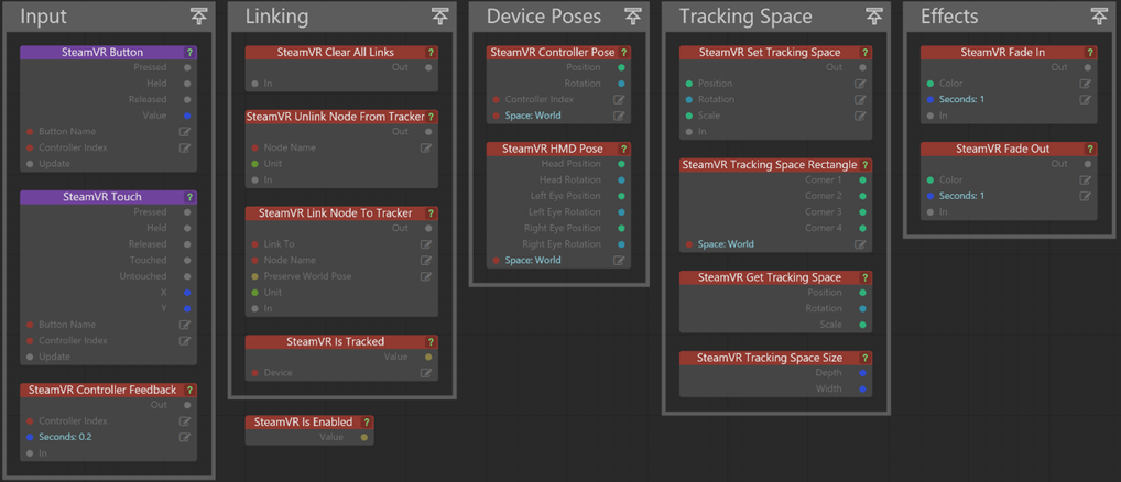

Input nodes
Used for button presses, touch input, or haptic feedback.
Linking nodes
Used for attaching objects in your scene to the devices that are tracked by the VR system, like your controllers or HMD (Head Mounted Display).
Device Pose nodes
Provide information about where your tracked devices are located and how they are oriented.
Tracking Space nodes
Used for mapping the real-world tracking space defined by your VR system into the virtual environment of your project.
Effect nodes (HTC Vive only)
Let you create simple Fade In/Fade Out effects.

The following Flow nodes are available in the VR HTC Vive template:
