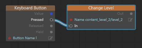

In this step, you'll set up some basic Level Flow to swap between your two levels in response to the player. To keep it simple, these instructions trigger the change when the player presses the l key; you could use a different trigger if you prefer.
Open level_1, and open the Level Flow editor.
Add an Input > Keyboard Button node to the graph. Set its Button Name value to the key you want to trigger the change. For example, the image above uses l.
Add a Level > Change Level node to the graph. Set its Name value to point to content_level_2/level_2.level.
Connect the Pressed output of the Keyboard Button node to the In port of the Change Level node.
Save the level.
Repeat all the steps above for level_2, but set its Change Level node to change back to level_1.
