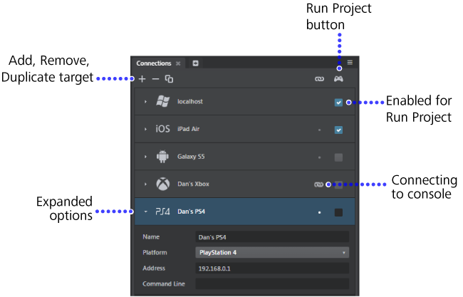

You can use the Connections panel to configure remote devices and web browsers as targets for the interactive editor. Once set up as a target, you can run your project on the device or in the browser. You can also mirror the editor viewport to a connected device. (Mirroring the viewport to a browser is not currently supported.)
| To... | |
| Add a target platform | Click  in the toolbar, expand the new target and enter a name, platform type and IP address. |
| Remove a target platform | Select the platform and click  in the toolbar. |
| Duplicate a target platform | Select the platform and click  in the toolbar. |
| Launch a data compilation for a target platform | Right-click the target and select Compile Data or Compile and Bundle Data. |

To make your device mirror the editor viewport:
 in the Connections panel, or
 in the Connections panel, orOrbit in the viewport to trigger a refresh. As you make changes or adjust your view in the editor, you'll see the changes instantly on the device. The editor synchronizes the field of view in the engine viewport on the device with its own viewport, letting you see how everything looks when rendered by the platform-specific renderer.
To run your project on the device in standalone mode:
Select the check box for your target below the Run Project button  in the Connections panel. This marks the selected device as a run target.
Click the Run Project button  at the top of the Connections panel.
