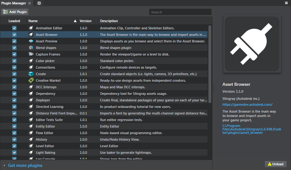

The Plugin Manager panel lists each plug-in visible to the interactive editor, along with detailed information and activation status for each. You can use this panel to control which plug-ins are currently active in the editor.
Unloading a plug-in removes any customizations the plug-in adds to the editor, including menu items, panels, custom actions, additional project resources, and special asset types.
You might want to do this if you know you won't need a given plug-in anymore, if it's causing a problem or interfering with your work, or while you're testing a custom plug-in that you are writing. (However, we don't really recommend unloading any of the standard plug-ins that come installed with 3ds Max Interactive, since you might miss out on key product features.)

To remove a plug-in entirely so that it's no longer listed in the Plugin Manager, select the plug-in in the list view and click the Remove button at the bottom right.
Note that you can only remove plug-ins that you have installed using the Add Plugin or the Get more plugins button. You cannot remove any standard plug-ins that are installed with 3ds Max Interactive, or any plug-ins that are found in the current project; you can only unload them.
Alternatively, you can delete the plug-in you want to remove from disk (or move it to another location on your computer), then press F5 to refresh the list.
Don't be afraid; removing the plug-in in this way doesn't delete the plug-in files from your computer. You can add it back again anytime from its old location on your disk.
